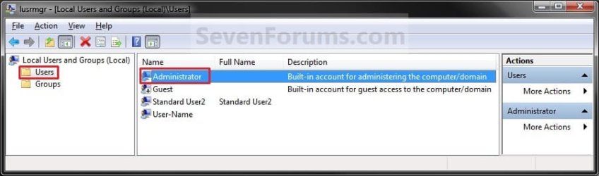

1. Open the Local Users and Groups manager.
2. In the left pane, click on the Users folder. (See screenshot below step 3)
3. In the middle pane, right click on Administrator and click on Properties. (See screenshot below)

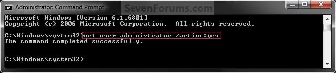

1. Open an elevated command prompt, and do step 2, 3, or 4 below for what you want to do.
2. To Enable the Hidden Built-in Elevated Administrator Account
A) In the elevated command prompt, copy and paste the command below and press Enter, and go to step 5 below. (See screenshot below)
NOTE: If you had previously renamed the built-in "Administrator" account's name, then you will need to substitute administrator in the command below with the new name instead.
net user administrator /active:yes

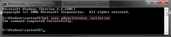

4. To Disable the Hidden Built-in Elevated Administrator Account
NOTE: This is the default setting.
net user administrator /active:no
5. Close the elevated command prompt.
6. Log off, and you will now see the built-in Administrator account log on icon added (enabled) or removed (disabled) from the log on screen. (See screeenshot below)
NOTE: Click on the Administrator icon to log on to the built-in Administrator account.

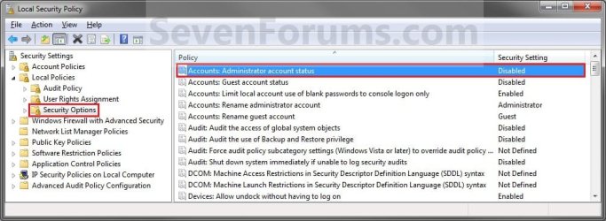

1. Open the Local Security Policy editor.
2. In the left pane, expand Local Policies, and click on Security Options. (See screenshot below)
3. In the right pane, right click on Accounts: Administrator account status and click on Properties. (See screenshot above)
