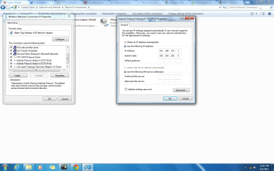

And I have uploaded a screenshot of my adapter settings. Every time when I try to share my connection through wifi my adapter. It automatically enters that by it self and when I change it to automatic it takes forever and it still doesn't fix it :(

You might want to try entering the default gateway of the modem 75.66.126.1 where it says Default Gateway in the IPv4 properties window. Manually entering the DNS servers might also help.
If that doesn't work it could be a limitation of your modem so you might try installing a virtual router like in the link below.
Virtual Router - Wifi Hot Spot for Windows 7 / 2008 R2
