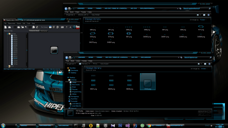

Found THE theme on DA. Though I'm having some troubles with the finishing touch.
Indead of a custom DLL the creator of the theme added PNG images to replace manually, and that's the problem.
I can not add non-BMP images.

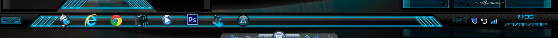

Also, none of the themes successfully chance my taskbar if they have some graphic in the center of it.

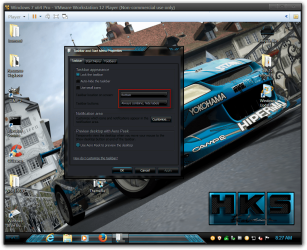

Do you have your Taskbar Properties set like in the screenshot I have below if not the taskbar will not show properly.

Oh wow can't believe I didn't try that haha. Thankyou mate, that did the trick!
