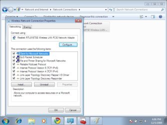

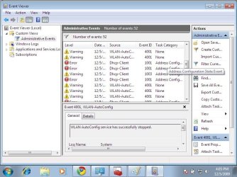

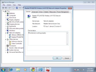

I know you guys are probably sick of hearing about this stuff. Sorry
I'm using an Eeepc 900hd, just loaded windows 7 ultimate on it. My wireless driver is up to date (so it says, although I've tried to install a new driver, but it "doesn't work on this operation syste,").
I turned off my firewall, followed most of nosferatu's directions in another thread, and I can't seem to figure it out. Everything else can connect to my wireless network (ipod touch, windows xp) but this one can see my network, but when I try to connect, it fails everytime.
I tried disabling the WPA password and it didn't work.
Any other suggestions?

There were some problems reported with your bios not having wifi enabled by default.
If you have the tray utility insalled just enable WiFi "WLAN" from there. If not then press F2 on startup befor the OS loads to enter the bios. It is under intergrated periferals.

Thanks. It is enabled.
I can see my wireless network from the tray icon, it asks for my password, and then fails to connect.

I'am seeing quite a few similar complaints. Must be a driver problem but no clear resolution so far.
I was able to install Windows 7 RC on my Eee PC 900HD. Everything eventually worked, to include the graphics...although I didn't try the FN keys, but for the life of me I cannot get the wireless connection to work. It sees the network hardware resources but doesn't find a wireless network. (When it was out of the box -- with XP Home-- it found my wireless and I've never had any issues with my other wireless laptops.) Has anyone else been able to get this to work?
There is however an updated wireless LAN driver for your Eee PC 900 HD dated 7/7/09 located at the Asus site. http://support.asus.com/

I tried the updated driver and no dice. It wouldn't let me install it because, even though it was the windows 7 driver, it said it won't install because it's the wrong operation (sic) system. Odd

The one I found at the Asus site is an updated version of an XP driver. I didn't see any drivers for Windows 7 there for your Eee machine. Maybe you didn't input everything correctly on the way to the driver.
