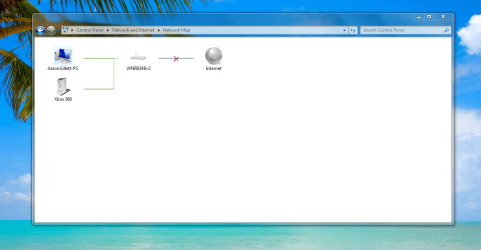

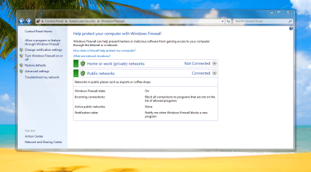

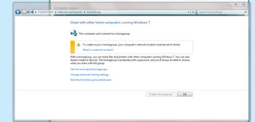

I am not sure what happened but I can no longer change back to my "Home" network and the default is "Public". It also lists me as having "No connections are available" when I am clearly connected to the internet. Without my Home network setup I cannot stream media to my television or gaming devices. I tried tried almost everything without installing Windows 7 again. Any assistance would be greatly appreciated. I added photos of my many problems.

Well neither solution worked. I don't understand what happened or how it even changed to the "Public" network setting.

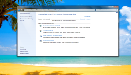

The problem resonates with the picture below. I can't change back to my Home network and will only allow me to be under a Public network. The public network is what's restricting my computer sharing functionalities.

I found this at TechNet, It should help you to change your network to Work or Home.
I have a real solution to CHANGE PUBLIC NETWORK to a HOME or WORK NETWORK . I had the same problem. I don't know if the thought behind it was to treat dynamic networks as hostile environments, or whether the documentation that stated "First time joining a network - you can select HOME, WORK OR PUBLIC " actually meant first of ALL networks & not per adapter, but anyway:
  1. DISABLE ALL NETWORK ADAPTERS
  2. ENABLE THE ADAPTER THAT'S ONLY SHOWING UP THE UNCHANGEABLE PUBLIC NETWORK
  3. IN THE NETWORK AND SHARING CENTER, SELECT "CHOOSE HOMEGROUP AND SHARING OPTIONS"
  4. CLICK ON "WHAT IS A NETWORK LOCATION?"
  5. SELECT HOME/WORK
  6. RE-ENABLE ALL OTHER ADAPTERS
http://social.technet.microsoft.com...g/thread/878f7c4f-f287-4c75-a708-a2097f931435

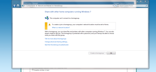

Thanks Chev but I am not even given that option at all. See Pic below.

agillet, open "Network and Sharing Center", on left hand side, there's "Change adapter Settings", click it. Once you click it, make a screenshot, then for every item in there, make a screenshot of it's "Properties" window. I think we can get the answer once we see what's in there...
