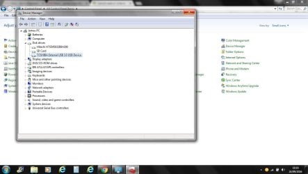

Open control panel-Device manager and see if all drivers are OK. If you see a yellow mark a driver is missing.

Thanks for advice, I cant see anything wrong with the drives from the device manager...I have attached a screenshot.
