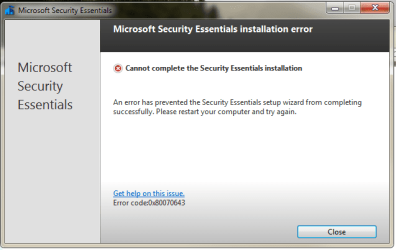

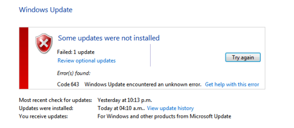

Ok, thanks the for the instructions, i deleted old CBSPersists CAB files, left only the last one.
You can see what's happening in the screenshots. Error 643 or 0x80070643.
In the process i tried uninstaling MSE and installing the new version from the Microsoft's website but it didn't work and now i'm unprotected.
In the middle of the process I applied the "Take ownership" command to the ProgramData folder thinking that was a permissions issue but it didn't help.
I ran the System Update Readiness Tool and sfc /scannow. I remember having good results from sfc but the last results told me that there were some corrupted files that coudn't be fixed. SURT ran without any trouble.
I tried the FixIt from Microsoft but it didn't solve anything.
