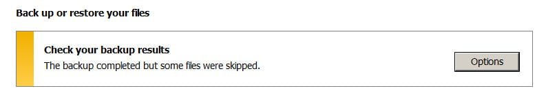

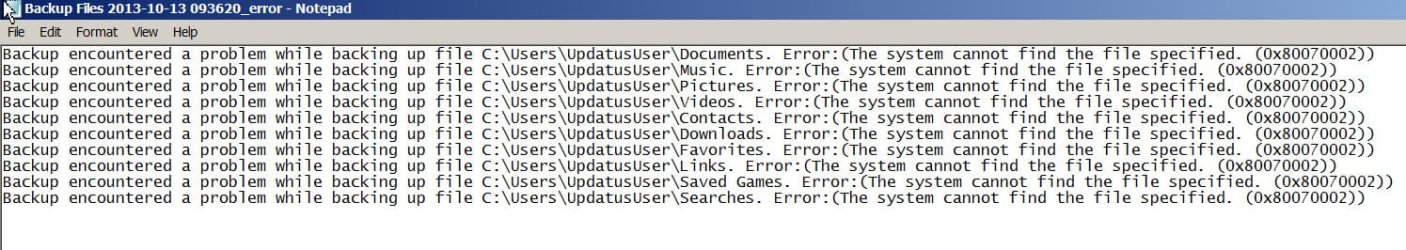

I do backup on my computers every Sunday using external drives.
For the last two Sundays I have experienced the attached error messages and have no idea what to do to get back in business. Never got these massages before.

Hello Joe,
That error means that the listed folders in the error report log are still included in your scheduled backup, but they no longer exists at that location. Windows Backup will still create the backup, but just skips backing up those folders and their contents since they cannot be found.
To stop getting this error, you would need to change your backup settings using step 4 in the tutorial below to uncheck (remove) these listed folders to no longer be included in your backup.
