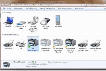

Hi Gang,
The below image should give you an idea of my a.) dilemma and b.) frustration (note name of default printer).
This is a Home Network printer. Windows 7 in this instance is running wireless on my Dell D-620. It did not like the installation disk for the HP printer, but was able to locate internal drivers for it. It's set up using the IP addy. Sadly, it doesn't like to hold the printer mapping over time, and frequently drops it. I've tried a few things, but only removing/reinstalling the driver seems to solve it, and even then only temporarily. Problem is, the ghosts that you see in the pic. I remove them using "remove device" but they only reappear on refresh, or restarting of the "Devices and Printers" window.
HELP suggested removing in Device Manager, but there is nothing there to remove. I'm sure I am not seeing the clear answer here. Can anyone offer a suggestion? I just want those ghosts out of there and my life back. ~~ :o ~~

I am a little surprised that nobody has responded to this. Anyway, the problem is on the back burner for me at the moment. If anyone has a thought, would appreciate. Any time's good. T/hanks

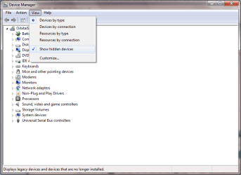

Hi tfcolligan, sorry for the late reply.
Have you enabled the 'Show hidden devices' in device manager?
   Note
You may need to change to the different views to see if there are any 'ghost' devices installed
Hope this helps :)

I have the same problem with HP4580 printer. I now have about 6 of them installed! Clicking remove device works until you refesh. Every few days the printer and computer stop talking and I have to reinstall. My PC on xp and my hubbys mac work fine (as did my laptop when it was vista). I have tried the above suggestions.

It works!! Some of the printers where still there after deleting. If you right click on them (in the devices and printers menu) and click open it says 'documents in queue'. Cancel the print jobs and the printer will then delete from the devices and printers menu.
