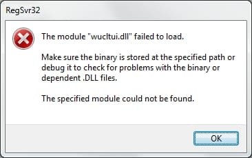

Hi, Anak. Thanks for the welcome. Unfortunately, that's one of the potential fixes I came across when scouring the web before I posted on here and it didn't work for me. All of the regsvr32 commands worked, except the one shown in the attachment below.

DJS, I did some lookin around, and the REGSVR32 WUCLTUI.DLL should be REGSVR32 WUCLTUX.DLL The last letter is an X, and not an I, try that and see if it succeeds, then go and try the up-dater again.

That didn't work unfortunately, Anak. The DLL registered, but it made no difference to installing WLM.
