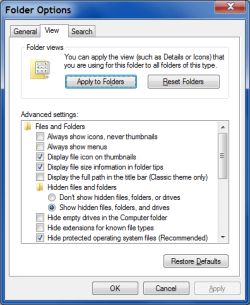

You need to set your own templates as Windows decides what to show you in Windows Explorer based on the files that are in a folder.
For example, you may have a group of text files in a folder and it may be displayed a certain way in Windows Explorer (e.g. Details).
If you add images, music or video files, Windows Explorer may change the way the info is displayed (e.g. swap to Large Icons).
What you need to do is go to a folder:
  1. Choose the Folder Template you want from the list
  2. Set the Detail columns and View
  3. Go to the View tab in the Folder Options window
  4. Click on "Apply to Folders"
What I normally do is:
  1. Initially set my all of my folders to the "General" Folder Template
  2. I choose the Details that I want to see in Details view (and set the column widths)
  3. Click on "Apply to Folders"
I then set the templates for other folder types (e.g. music, pictures, video, etc.):
  1. Set any extra Details or change the View (e.g. Large Icons) that I want for that folder
  2. Click on "Apply to Folders"
  3. I repeat this until I have set all the Folder Templates I want
