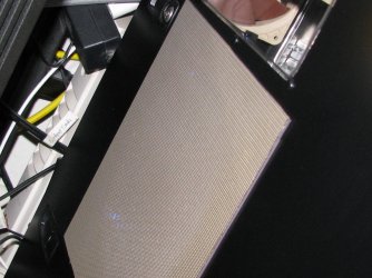

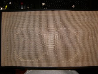

Please consider this as an option and then the filter is easier to clean! Way easier to clean !
DemciFlex
I cheaped out and made my own with window screen and sticky back magnetic tape and they work great.
