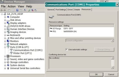

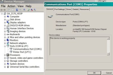

This is my MB Com1. I think it is built in the Z170 chipset
