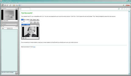

did you see this page?
No joy on the firewall. That test page i believe is for iLinc 10 and not 7.7. I have done that test page and passed.
Okay i think that I know what page you were getting at. I tried the test for 7.7 and I get the same type of error
