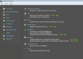

I always run Speccy in the background and the temperatures are always low (see screenshot). I checked the fans just now. They were relatively clean (I cleaned them just a month ago) and they were working.

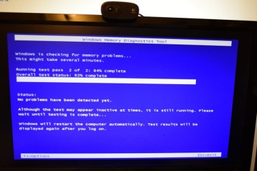

Memory test can last a day. If the computer booted in minutes, run it again and stay close for about 10 minutes (fist pass).
You can clean the memory contacts.
- Shutdown, remove the power cable from the power supply and wait 1/2 minute.
- Remove one memory stick at a time and clean with a cloth with alcohol. Let it dry before inserting back into the slot.

OK, I've followed instructions. I cleaned the memory sticks and contacts and then ran the mdsched again. Same result. It goes very quickly--like the entire program takes around 10 minutes--then the computer restarts and I'm at the login page again and when I typed in my password, I go to a desktop that is frozen (I can't access any of the programs). I'm including an image of what I see right before the computer restarts. Please help.

Did you install the hardware monitor as I suggest on post 4.
You may have high CPU temp and it slows down to cool.

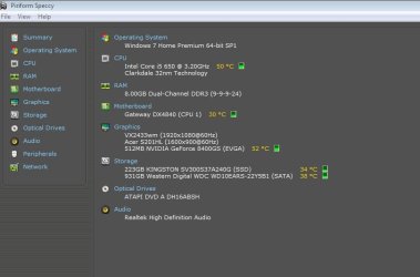

I've had Speccy installed for years. It's not the temp (see screenshot). The fans are working too.

Ray, 50ºC doesn't mean much. What was the Max?
I already used Speccy. Didn't like as it is medium.
There is HWiNFO, that is much more complete, and is good to find information.https://www.hwinfo.com/download.php
My favorite is Open hardware monitor. Downloads - Open Hardware Monitor
It isn't so complete as HWiNFO but it's light, logs Max and min (temp, voltage, fans etc) and you can see the CPU temp at the task bar.
Mine starts with windows.

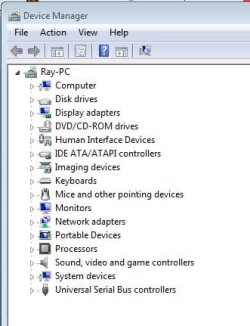

It boots in safe mode. It boots mostly in normal mode too. Every 4th or 5th time, however, it stalls. And occasionally, in the middle of working (after I've had the computer working for a few hours), it stalls (i.e., the hard drive got stuck). I've run device manager but see no yellow alerts (are those yellow question marks? I don't know). I'm include a screenshot.
Windows 7 Home Premium x64 Service Pack 1
Gateway DX4840
Ray, all devices are now with their right drivers (no more yellow alert marks).
Check disk, system file checker and memory check didn't find any problem so I can't think of anything else, sorry.
Try superantispyware. SUPERAntiSpyware - SUPERAntiSpyware Portable Scanner
