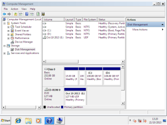

This is what shows up in Computer Management

UPDATE:..............This matter was resolved via my thread (Windows starts/uploads fine but partition screen keeps popping up) So if anyone has any issues like this then check out that thread and maybe it will be of some help to you too.
