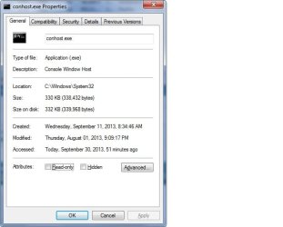

rzn6jw,
Did you look at the conhost.exe file properties, and see if it is running from the system32 folder?
Is it a Microsoft file?
Please post the General and Detail tabs of the file's Properties.

Yes, it looks like it's coming from the system 32 folder (I'm running 64 bit Win 7 Pro).

Size = 0 Bytes!!! Oh boy!!
