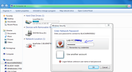

I have windows 7 home 64bit. I have Seagate NAS 110. every time i'm trying to connect to share drive/folders it keep telling me Logon failure: unknow user name or bad password. What is the Next Step that i can do.

Has this worked previously and now it doesn't ? i.e. you are using the same login and password as you used to but is now not giving you access ?

@ibshaw: How you doing? Yes, It worked previously but now it doesn't? It some time work and some time doesn't!! The login name and password is same as before:

This sounds more like a network problem rather than a rights issue - how are you connecting to the NAS ?

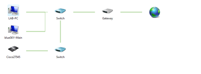

all its missing is my seagate Netwok Storage becasue it off right now

What is the Cisco 27545 hardware?
Is the internet gateway that is showing up there actually a router?

yes its cisco 4200 router

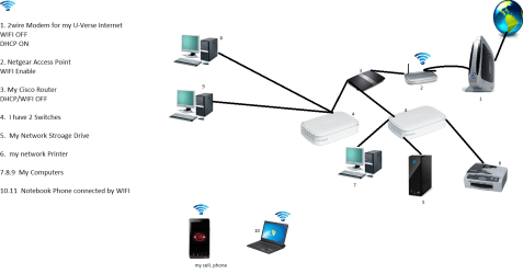

here is my HOME Network is Set Up by Numbers

I can't really say if this concerns the log in failure though it may be a contributing factor, but I would try setting this network up differently.
With the DHCP router going through an access point first then into another router this may not be a very reliable network even with DHCP disabled in the second router. As it stands you are using the Cisco router as a switch anyway and routers have firewalls and other types of port blocking built in, unlike a regular switch.
I would think about replacing the Cisco router with a regular switch then plug the A/P and the other two switches into the first switch instead.
Do a reset on the DHCP router then check the A/P to make sure it picked up an IP.
At that point the network should be plug and play and it should be possible to access your NAS.

@chev65: Thanks Buddy I will try to move my network setup like you said! I was thinking the same think.
Some Time its work and some time the windows ask me again and again to enter my user name and
Password. ???? Some time if I reboot my Computer Twice than everything works (sometime).
I never had this problem before. After Clean Install of windows 7 64bit, Everything Works great but after some updates (SP1 after) its start to screw with problems?????

The best and only way to do this in my opinion is to remove one of the routers from the system and don't use the A/P as a pass through switch. You want to plug the A/P into another switch and don't plug another router into the A/P, then remove one of the routers from the equation. I would definitely go with the Cisco router first in the system as the main router rather than using the ATT modem router combo which should be tossed. :)
Using dual routers in a single network is a hit or miss type of deal and no matter how well you set them up it may not be reliable. I won't get into the fact that every time there is a power outage you will need to go in and re-set up the secondary router all over again. Configuration files come in handy for this.
If you want a chance at getting this set up for dual routers the link below might help you get all the setting correct.
How to Connect Two Routers on a Home Network
