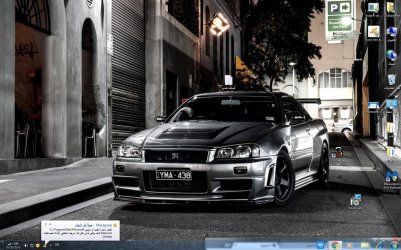

Look at the start menu.. It's almost empty. there is nothing. only my games.. also there is no paint.exe and no system restore. all of them are gone

Hi Abd,
lookin at those logs.
RE-run malwarebytes, in the settings dashboard enable Rootkits, it was off last time.
Set it to auto quarentine.
There appear to be 2 infections, not 1.
Those shortcuts to your programes in the start menu,system restore and paint WERE ALL INFECTED, (anything with ".ink" = shortcut).
They have now been removed by ESET.
Did you only select them to run against the C drive?, if yes you need to select D and E as well.
It would appear that the infections came via an infected USB! device, throw it away

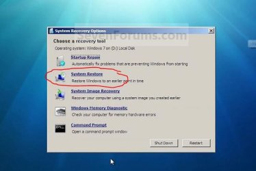

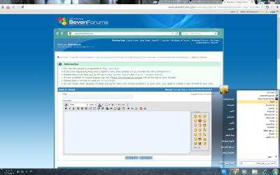

3. well... system repair caused this problem.. when my pc wasn't booting up.. i went to system repair. i did it. after booting. all problems happend.. this is why i created this thread :shock:

Here is a picture about the message.. look down at the corner at the left
the translate:
mxup.exe - error in system
(corrupted file) file or registry C:/ProgramData/Microsoft/Network corrupted and unreadable. Please run the helping tool CHKDSK.
(The translate is not 100% but this is what i can)
