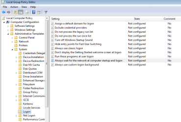

The keys will not be there unless you manually create them or use GPEDIT.MSC to create them.
The Group Policy Search website that I linked to offers the path to follow in GPEDIT:
Computer Configuration\Administrative Templates\System\Logon\
For those that do not have GPEDIT, the website offers the registry path too:
HKLM\Software\Policies\Microsoft\Windows NT\CurrentVersion\Winlogon
I have attached the setting as a reg file...
...in case you want to take that route.

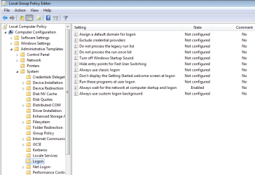

Ah yes, I found it in GP Editor, changed that setting to Enable, then restarted. Still said could not connect all network drives.

Perhaps that GPO setting only helps with drives that were manually mapped - not mapped via log on script.
I'm not sure what else to try.
