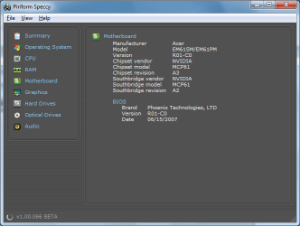

See attachment for motherboard model. I have a budget of $160 and I'm looking for a decent 500 GB - 1 TB internal hard drive. Another question, can I have two internal hard drives installed on my motherboard? I've read somewhere that you could, I just want some confirmation.

I found an Internet post that says your motherboard has two SATA connectors and one IDE connector.
It's up to you to visually confirm that with your own eyes. You need to find out what the unused connectors are and then buy drives that use that same type of connector--either IDE or SATA. Your existing drive could be either IDE or SATA.

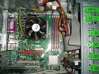

Will I need a SATA controller card?
(The attachment is old, before I upgraded the processor and added a video card)

The picture shows two SATA connectors (orange) at the lower right of the image. One of them is used for a hard drive, the other is free.
If you only wish to add a single SATA hard drive, you won't need an add-on controller card.
