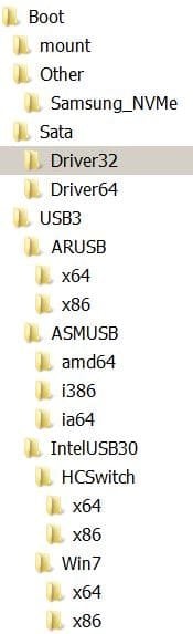

- Create a folder tree (any place you like) as below:
- Extract the Sata, USB 3 files and any other drivers (like MVMe disk driver) you have downloaded.
- Place the 32 and 64 bits Sata files as extracted (it can have folders and sub folders) on the Drives7\Boot\Sata folder.
- Place the 32 and 64 bits USB 3 files as extracted (it can have folders and sub folders) on the Drives7\Boot\USB3 folder.
- Place the 32 and 64 bits other files as extracted (it can have folders and sub folders) on the Drives7\Boot\other folder. If you don’t need any other drivers, leave it blank.
- Place the 64 bits Sata files as extracted (it can have folders and sub folders) on the Drives7\ Install \Sata folder.
- Place the 64 bits USB 3 files as extracted (it can have folders and sub folders) on the Drives7\ Install \USB3 folder.
- Place the 64 bits other files as extracted (it can have folders and sub folders) on the Drives7\ Install \other folder. If you don’t need any other drivers, leave it blank.

From \sources of your Windows 7 installation disk or iso file, copy Boot.wim to Drives7\Boot and Install.wim to Drives7\Install.
Place *.cmd as below:
Drives7\Boot:
Drives7\Install

Head up, I had to use the full path to the .wim file
C:\Windows\SysWOW64\dism /Get-WimInfo /WimFile:C:\Users\Owner\Desktop\W7Setup\Drives7\Drives7\Boot\boot.wim
Pause
Fedora 16, Win 7
Fedora 16, Win 7
Is the cmd file in the same folder as Boot.wim, in your case C:\Users\Owner\Desktop\W7Setup\Drives7\Drives7\Boot?
I see that you have W7Setup\Drives7\Drives7. Is the cmd file at W7Setup\Drives7 and Boot.wim at W7Setup\Drives7\Drives7\Boot?

On the image
Left is Drives7\Boot
Right is Drives7\Install
