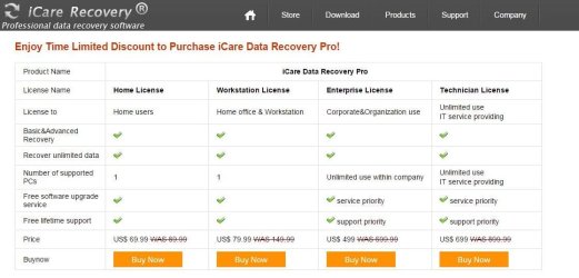

I came across into one software called "iCare Data Recovery" and tried that out. Within a few minutes, program was able to recover pretty much all of my folders with all belongings, yes that is right not just pic, mp3 etc but the whole folders with movies, software etc... the total of 203 GB size data 20807 files. In the mean time while I'm typing I'm recovering them into my external hard drive. Free version of the software allowed me to retrieve only 1 GB file so I found portable version online with unlimited data recovery. It is iCare Data Recovery Pro version 7.6.1.0 portable.
Special Thanks to "jumanji" who encouraged me to try rather than just give up.
I think problem is solved and we can go ahead and close the Thread. Thanks all for participating.:party::party::party:
Windows 7 64 bit
Windows 7 64 bit
That would be a pirated version though :p
