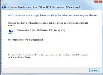

Thanks for the link m8, but i'm still in trouble.
While i try to install the driver for win7 64bit version i'm getting this error (check screenshot)
I've tried rebooting and nothing.. i will need to reinstall win7 to make it work?

i've just reinstalled win7 and i'm still stuck... same error when trying to install win7 drivers
Try going to Windows update and see if you can find the D-link update for Windows 7.

Thanks mate. It's located under optional updates on the Windows Update:p
