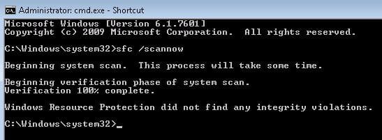

I don't know enough about db2 to know what to look for in that log. Try opening up command prompt as an administrator (right click and select run as administration) and then type in the box sfc /scannow. Try running that 3 times.
Kindly, see the sfc.jpg attached. Please, could you tell me how it relates to my problem and how would sfc be helpful in my case?
Windows 7 64 bit
That was to make sure that there aren't any problems with system files. As I've explained I don't know much about db2 so I don't think that I can help you further. I'll see if someone else can.
