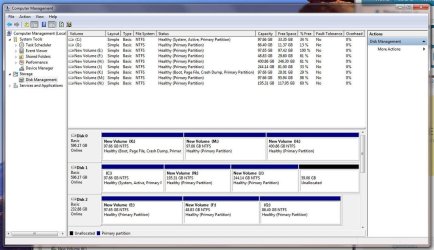

I have an existing Vista install that I'd like to just uninstall or delete. My Windows 7 has been installed for some time and everything that needs to have been deauthorized or uninstalled from Vista has been taken care of.
Vista is on C and 7 on K in the attached Disk Management screen.
I've seen other threads that refer to both being on the Boot drive but I do not believe that to be the case here.
Your perspective and expertise is greatly appreciated.

It looks like the master boot record is on K, but I'm not 100% sure. It would be good to have a 7 install or recovery disk ready in case. If it is actually on C and you delete it, you will have to run a startup repair 3 separate times, with reboots in between. As for actually deleting it, please refer to the tutorials below.
http://www.sevenforums.com/tutorials/2668-partition-volume-delete.html
http://www.sevenforums.com/tutorials/2670-partition-volume-extend.html (to extend one of the volumes to use unallocated space)

You will need to mark the Windows 7 partition "K ?" as "Active" and do as many as 3 separate startup repairs with system restarts between each repair to create the boot file to Windows 7, have a look at the tutorial at the link below to get some perspective on this and if you have further questions feel free to ask.
Startup Repair - Run 3 Separate Times

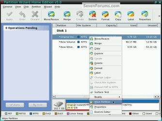

If he just deletes it he'll have to use a 3rd party like PWBD to recover the space back into another partition; though it would be a good idea to do a wipe of the "Vista C:" partition first (before it's deleted) to remove any old Windows code and then it can be resized if needed.
Partition Wizard : Use the Bootable CD

Just to confirm that from the drive management shown the active drive is the C: drive and deleting this partition will render the win7 install un-bootaable.
This is not a major issue but will need the start-up repair as suggested above.
I assume from the fact that the win7 installation shows as K: that the install of win7 was made from inside vista - or is the screenshot from the Vista install ?

Wow! Thank you all for the information. To answer one of the questions asked, The screen shot of Disk Management was taken while booted to Win7. So, I'm not sure if that changes anything.
I'd obviously been hoping that since K: (Win7 install drive) is also a boot drive, I'd be able to delete the entire C: drive contents and rename K: to C: using Disk Management.
Would it seem I am too optimistic?
Thanks and regards.

As stated above, the problem with renaming it is that all of your programs look for files on the K: drive to run, and the lack the ability to simply scan the whole computer for them. This means that the programs would not run correctly, if it all. I also have serious doubt about any shortcuts working.

Hello mate, what you're seeing as "boot" just means that is the OS that is booted or running at the time, nothing else; I hope this clears that up for you.
Don't forget to post back with what you decide to do and any updates.
