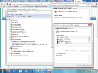

Everything is good until I put in a PCI envy24 sound card.
With sound card functioning properly, the intel pro100 has an exclamation mark.
One time I uninstalled both devices and rebooted. Windows found the drivers and it all came up working including the intel pro100. Then a reboot and back to the yellow exclamation.
I see alternative button for sound card but is grayed out.
So what would be a way to resolve this?

I'm no expert but the window above that is showing no conflicts is for the sound card. Might have been more helpful to post the same window for the device with the exclamation mark, to see what the conflict is exactly?

The properties page for the intel pro100 shows nothing useful, says it has a problem and is not using any resources.

And I'd try looking for an updated driver for the sound card. It is revealing that everything works fine in Linux... proves all the hardware CAN play nice together, given the proper drivers! I'd also suggest looking for an updated driver for the pc100... that could also be the problem, especially since it couldn't even report what conflict it had.
After installing any new drivers (assuming one or both can be found) if a conflict persists, repeat your procedure of uninstalling the problem device in Device Mgr (do not tick box to uninstall drivers), then click the "scan for new hardware" and let it reinstall... if they can play nice even once it means the problem is in how they are loading at boot up... again, grabbing for the same resources somewhere... and staggering their installation will hopefully solve the problem.
EDIT: The other option is, since you don't use the pro100, just remove it from the machine... or use Dev Mgr to disable it in W7 if you use it in other OSs. But what you are getting is def a resource conflict. That is... the pro100 goes to load and it can't because it needs something another device is already using... so it doesn't load at all and you get the exclamation and "no resources being used"... and same with the sound card causing problems on other machines... it sounds like a bad driver.
