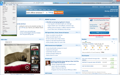

I would think just setting IE to work offline would do the trick, picture below.
You can right click above the tabs to enable the menu bar then just click on file and go down to where it says "Work Offline" and click that.
