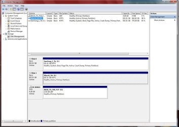

Can you give us a screen snip of your Disk Management ?

Do post a screenshot, but it certainly appears as if you just have your boot drive (C and E) connected to controller 1. Shouldn't be a problem. You can attach either drive to either controller. Disc 0 doesn't have to be the boot drive.

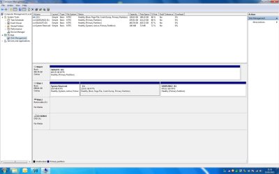

here it is

i often reinstall but its gone a bit dopey this time, my thoughts were it should be the seagate 0 as primary boot

here it is
It looks OK. I assume you want to reinstall to the Samsung. If you want, you could swap the hard drive cables at the motherboard port and reboot to confirm that the Samsung then becomes Disc 0.
And then do your reinstall.

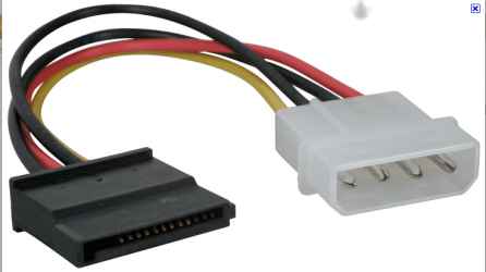

Just find the Samsung HD, with the computer turned OFF. Disconnect Power Cable sata_Power_Cable_.PNG
Also here is the data cable
