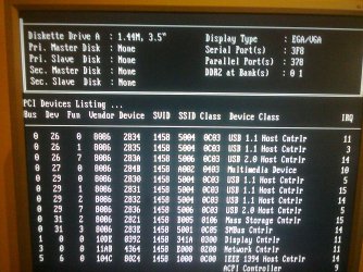

hi gregrocker thanks for the reply and the help so im fairly sure ive done everything you asked and something new is happenin but i still cant load win7 so ive uploaded these pics so any help gregrocker would be fantansic and again thanks
more writing flashes down the screen on the pic above but its to quick for me to take a pic hope these pic are of use

Do you only have a CD drive? Win7 is on a DVD, not CD.
How was the flash installer written to stick? Use the latest official ISO for your licensed version written to stick with the tool also provided in Clean Reinstall - Factory OEM Windows 7.
Boot into BIOS setup to set the hard drive to boot first, save changes and Exit. Then plug in the stick and trigger it to boot on the Dell F12 one-time BIOS Boot Menu key, under flash, USB, or HD. You may have to expand a listing. USB FD may be for floppy drive.

Were you using bootable flash stick when you got the BIOS boot dialogue you posted, because it may be saying it doesn't not support USB boot?
Is it possible BIOS got reset to AHCI from IDE (or vice versa) causing the hang at Start animation? Welcome to GIGABYTE Technical Support! - Page 74 Try all SATA controller settings.
Is there a newer BIOS update?
hi again gregrocker an thanks again for the help ive red true that link an tried everything it said ive switch from ACHI to IDE an nothing it just still hangs on the second screen i already posted iv tried bootin xp and vista an the same thing happens i would be grateful for any more suggestions thanks
