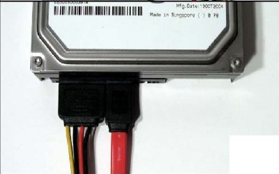

My suggestion would be to use an external hard drive and copy out your personal information with the Linux CD. The reason the Linux will work is because it runs from ram and does not use the hard drive. If it can see and copy the personal data from your drive, I would do that as soon as possible. If BIOS and the operating system cannot see the hard drive, it is going to be quite difficult to test it. But, I agree it sounds like the drive has died. In your video you showed 2 cables. The wider cable with the 4 wires provide power to the drive. The narrow orange cable is the data cable. Both have to be completely seated for the drive to be seen and work. I would suggest you make sure both ends are connected completely. The data cable will connect to the motherboard and the power cable will connect directly from the power supply or connect to a 4 pin connector coming from the power supply. You can also start the computer and feel the drive to see if it feels like it is spinning.

This is what it should look like properly connected.
