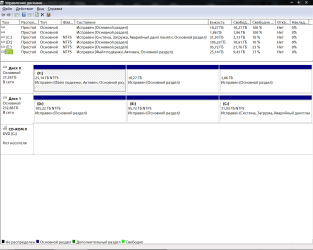

Please post back a screenshot of your maximized Disk Mgmt drive map and listings, using the Snipping Tool in Start Menu.

I will attach the screenshot; however, I don't have the option of rebooting with English UI, so I'll provide the info below in written form as well.
Disk 0 :
F - Basic - Primary - NTFS - Healthy - Paging File, Active, Primary // just files
? - Basic - Primary - ????? - Healthy - Primary // That's where Ubuntu is installed
? - Basic - Primary - ????? - Healthy - Primary // That's Ubuntu's swap
Disk 1:
C - Basic - Primary - NTFS - Healthy - System, Boot, Dump, Primary // That's where win7 is installed
D - Basic - Primary - NTFS - Healthy - Primary // just files
E - Basic - Primary - NTFS - Healthy - Primary // just files
Again, worked\hibernated without any issues for a long time. Then the MFT of 'E:\' partition got messed up, so I restored the files and then formatted it, as well as reinstalled Ubuntu (to the same drive with F:\ partition).
I will provide diskmgmt screenshot with English UI if necessary but can't do that right now, unfortunately. And again, thanks for the answer. It's not a huge problem, but the hibernation is very handy.
