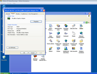

Here is what I did.
I found the VMLites folder under C:\Users\YourName\VMLites\VMLite XP Mode and opened the file " VMLite XP Mode.XML " in Wordpad. I changed the value 126 to 256 as stated above in the same line as above, "<Display VRAMSize="126" monitorCount="1" accelerate3D="true" accelerate2DVideo="true"/>" then saved it. I opened the VMLite Workstation and opened Settings/Display to see if the value was changed and sure enough, it now said 256 for the max video ram available. Next I wanted to test if XP Mode itself saw the same value so I started XP Mode and navigated to my video adapter page to check it and take the snapshot. This is found in, Control Panel/Display/Settings tab/Advanced/Adapter tab.

Here is what I did.
