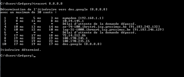

Just for the heck of it. Go into command prompt by entering cmd into the search box in the start orb and in command prompt enter the following: tracert 8.8.8.8

3) I'm not directly plugged in the modem anymore (using CPL instead) but the tracert 8.8.8.8 result (looks ok) is in attachment.

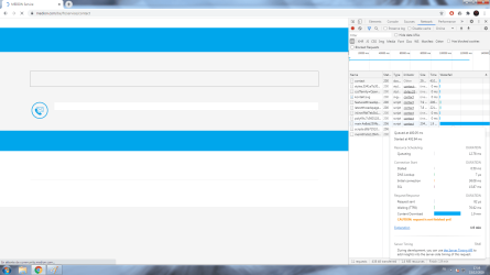

4) One last thing: I've put in attachment an image where you can see an example of the problem. As you can see it starts loading the page then it stays blocked on "downloading content". As you can notice on the right side (chrome inspect tool -> network) it stays blocked for minutes without progressing. This is exactly what is also happening to my files downloads, starting then blocking.
Thank you for your support.
