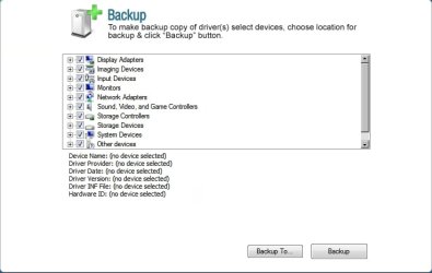

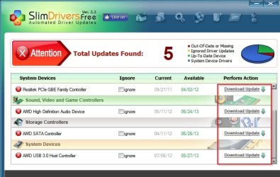

If using SlimDrivers:
Check the program's settings and uncheck the following:
Backup your existing drivers first:
Only download and install driver updates one at a time. Download one update and let it install. Reboot before going ahead with the next driver update. (Where Download Update is shown - don't select them all at once!). Sone security software could interfere with driver updates and could block or sandbox new unrecognized files.

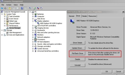

Use your computer for a while after updating a driver before installing anything else. If you notice problems either restore your original drivers using the Restore feature of SlimDrivers or else roll back the last installed driver using Device Manager.
