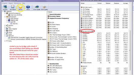

Now try this because the buzzing sound has me wondering if the PSU is not going south and genrally this components is very often overlooked as a problem cause.
Using HW Info PSU
Download HW Info and pick the right bit version -
HWiNFO,HWiNFO32/64 - Download -(click on link or copy and paste this site into the search bar) If you do not need therunning information in the smaller right hand panel close it. In the left handwindow click on the + for the individual device groupings and they will open outto the various components.
Go on opening out further until you get to the device itself. click on it and itwill highlight. In the right hand window there will be a verydetailed description of that device as in brand, speeds model number etc etcThese are very detailed and are just what is needed for searching for driversetc.
To get the PSU volts you need to select the Sensor button circled in yellow inthe pic for PSU testing do the same and scroll down the readout as in my pic towhere it has Nuvoton = yours might be a different section name / title. Postback a pic of that please.
