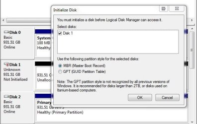

It also depends on the type of partition as far as MBR or GPT(GUID Partition Table). When going into the Disk Management when a drive is raw or simply not available to turn it online and then see a drive letter assigned when using the new volume wizard the option for mbr or the other is set for mbr by default.
If somehow the other is on that would stall everything since you configure things differently for the other partition style.

6 days later the mystery is solved.
Medion came good with a bit of info, only after I threatened to become an ex Medion customer.
"Windows Vista is producing a BSOD because the drivers installed on it are system specific. It works on the 'Core 2 Duo' because Windows has tailored the software to talk to the specific hardware in that system only. The MD8870 has different system components to the 'Core 2 Duo' which is causing the software to throw a STOP message. The BSOD will happen every time you boot from any other system that differs in system specifications to the 'Core 2 Duo'. The solution is to install Windows Vista on your external hard drive for the MD8870."
So, system specific! that is a strange one but, explains everything. 2 Win OS's incompatible because of the hardware they have been set up on. Not a bios problem but a front end problem.
The advice ignored the fact that windows will not install across a USB connection.
So, if I clean install one of my other drives into the Medion machine, it will then not boot in a core2duo machine?
Really defeats the purpose of dual boot doesn't it.
I would dearly love to know how that was achieved. Must be some sort of special driver but, how it is called is a mystery.
Something on the motherboard perhaps.
I guess I am stuck with a solitary machine, to which I can add a back up drive and that is it.
Thanks for your inputs guys.
