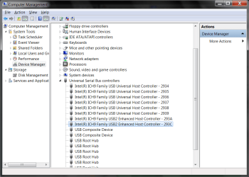

Ok post a screen shot of you device manager with USB controllers as shown in mine

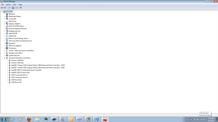

Ok the two usb 3.0 controllers see if the option is there to roll them back

Unfortunately, roll back is greyed out on both, which i don't understand......

Hmm expand "IntelWiUSB" and what does it say under it?

there are two devices:
Intel UoIP BUS
Intel UoIP Host Controller
