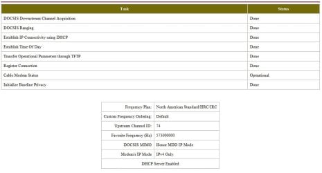

Here is some information if it is of any help... ....modem's status and configuration settings: (Please see attached images below.)
