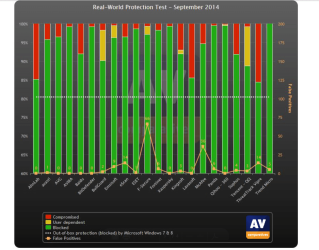

Yes mate I am just not a fan of the bloat AV's those stores put on and McAfee definitely not on my like list. See the list I the pic it might give you a few ideas
Mugel depends on whether you want a paid for or free but in my mind paid for is not as expensive as they sound if you work out how much per day they cost you. For example my Kaspersky on a good deal works out at $0.07 a day. But as always the choice is yours.
Anyway Anak has said it may be an update issue and I tend to agree. one thing you can do is to system restore and then work back with the updates until you find the culprit.

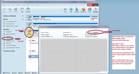

Well one test yo can try id this it takes a while but will rule out any surface damage and / or problms with the read / write heads.
HARD DRIVE SURFACE TEST
Now as opposed to the usual drive testersthis specifically tests the surface of (usually) a spinner.
It will test the surface of the spinningdisk, and I suspect some idea of the performance of the read / write heads.
Download this http://www.partitionwizard.com/free-partition-manager.html my pic will give you the instruction on what to do. It doestake some time but it does cover most possibilities with a drive in conjunctionwith the other testers like Seatools http://www.seagate.com/au/en/support/downloads/item/seatools-win-master/
I am not saying do it but it would eliminate and problem from the direction.
