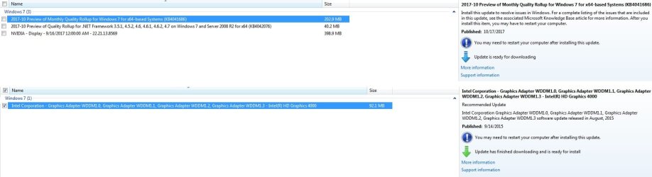

Everytime I download this windows update my monitor turns black
bobxxx
12:34 AM
13
As the title says, everytime I try to use the windows update on my computer for these couple graphics changes, my computer screen turns black and kinda goes into sleep mode. I end up having to restart the computer and system restoring it back to before the update.
Here are the pics of the windows update changes that Windows wants. I just ended up not doing them, but I am puzzled as to why this is happening and if whether it could be my graphics card, although I recently replaced my graphics card because I took it to the shop recently and they gave me a new one and did a diagnostics to fix issues.
Should I be worried and what can I do to fix it so I can update and not have this problem?

Which update is causing the problem ? The nvidia update or the Intel update ?
If you need an nvidia driver get it from nvidia, not through windows update.
If you are using an nvidia graphics card, don`t even worry about the CPU graphics, just hide the update.

Dissable MS driver updates, allways go to the manufacturer especially for graphics cards
NEVER install the PREVIEW updates.
And your comp will allways black screen when installing graphics drivers, unless there done on a reboot
(remove old drivers >> black screen >> install new drivers >> up and running)
It's the Intel update I believe. Because I tried doing just the intel update alone and it was going me the issue.
Also my computer is a desktop, Windows 7 64-bit with a GeForce Nvidia GTX 1060 graphics card. i5 processor, with DDR3 8 GB ram
Ok so the consensus is to just not do any windows updates on graphics card?
Roy
Ok I will update from Manufacturer.
Ya I know computers black screens for a couple seconds when you install graphics drivers but this is different. When I update, it just stays black and never comes back until I unplug the computer and restart it and then windows automatically states something wrong happened and asks if I want to do a system restore. If I don't do the system restore and go straight yo start up then it goes back to the black screen. I am practically forced to system restore.
