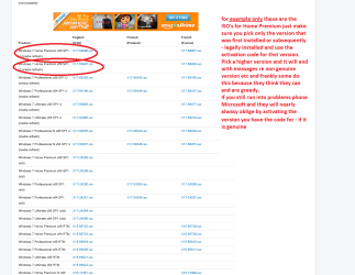

What I meant and was going to suggest is that to clean that drive properly is to retrieve any data such as pics Docs and any programs you really need (say paid for ones) and then do a complete reinstall.
This is a good tutorial to follow for the install as it has the latest ISO and will cut down on the updates http://www.sevenforums.com/tutorials/219487-clean-reinstall-factory-oem-windows-7-a.html this means though you have to format and get that drive ready as new to do this.
Just make sure you pick only the version you have others get greedy and it ends in grief - see pic
