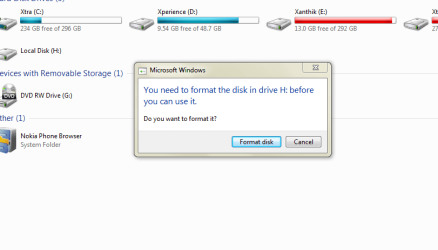

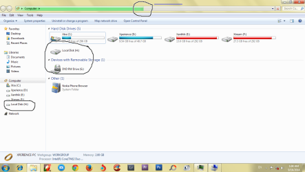

Hai,
I am New to this forum. Please Help Me
Yesterday I was watching a film in my External HD(WD 1TB).After finishing movie i disconnect the HD.Then It shows that "You need to format device to use".Then I again plug the HD .When I Opens MY computer the green task bar is running too slowly to respond.In left task bar we can see that the Hard disc letter but not responding.Even i cant shut down the computer with plug in HD. After Unplug the HD there was no problem to the system.

Hello again NISHADNASER,
Yes, as I suspected, your external WD drive has gone RAW like shown in picture 3. As I also assumed, you do have valuable information on it.
So do not click "Format", so you don't erase the information and your best option to save your files is through a Data Recovery Company. Here's a link again to WD's official Data Recovery partners:
