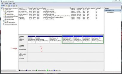

My external hard disk (Seagate) is detected in the task bar after connecting, but not visible in "My Computer".
It is visible in Device manager under Disk Drives but not under USB.
There are few threads in this forum which are similar to mine, except that their Drives are visible in the Disk Management as Unallocated Space, mine is not.
SEE ATTACHMENTS !!!!!!!!!
I've tried all tools, tried in Windows XP still no solution.
Is there any way to atleast recover the data !!!!!!!!!
Your reply is appreciated !!!!!!!!

If it doesn't show on Disk management it's a bad sign.
I would try to take the disk out of its case and put on a desktop.

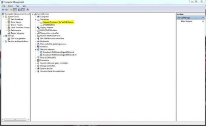

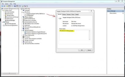

Your Device Manager screenshot in the first post shows the drive as "Seagate FreeAgent GoFlex USB device" which is a standard 2.5" drive in a box with an adapter cable.
Have you taken it out of its enclosure and connected it internally? I really do not understand what you are saying in the quoted post.

There is definitely something amiss here. How can your old laptop internal drive show as ""Seagate FreeAgent GoFlex USB device" ? !!!!!!!! I guess you are using the Seagate FreeAgent GoFlex adapter cable to connect your old laptop hdd. That is wrong. That adapter cable should only be used with Seagate FreeAgent GoFlex external HDD in its own enclosure/box/case ( by whichever name you call it.)..

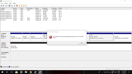

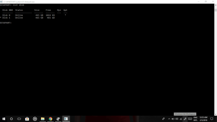

sorry sorry !!!! this screen short was my old hdd drive new screen shot i attach
Gujarat
OK, you tried to initialize it and it said "can't because of I/O error". And you ran Seatools and it failed. Sorry, your HDD is dead. You can't bring a dead man alive. Can you?
