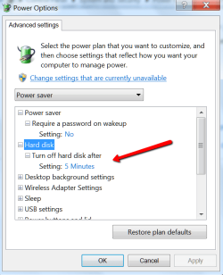

Go to Control Panel > Power Options > Change Plan Settings > Change Advanced Power settings
In the above picture, about 3 items down from the setting marked with the red arrow ( which is important) you will see USB settings. Expand those and the setting will say 'selective suspend setting', disable it. It allows windows to turn off usb ports to save power.
Also, as AddRam said, most hard drives are built to go to sleep when inactive. it takes a few seconds for them to wake up. That is perfectly normal and a power saving feature as well as longevity for the hard drive.
