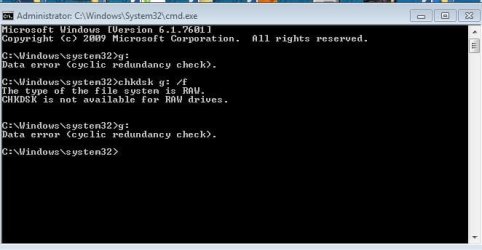

All of a sudden, one of my external drives is inaccessible. Anybody know how to retrieve data from it? I took the drive (WD Elements) out of the case, intending to hook it up to a SATA enclosure, but it's got what seems to be unremovable hardware blocking access.

The WD Elements doesn't have hardware encryption. It is, though, in RAW format. The cyclic redundancy check would be confirming it. This means it has had errors/damage to its partition table, hence the system can't read it correctly and doesn't allow access to it. The problem therefore has not been in the enclosure. But from removing the drive now the warranty has bee voided and the device can't be RMA-ed for replacement. :/
A RAW drive is hard to retrieve data from. You could a data recovery software on your own but it has risks to your drive and the data on it. You could try booting into an Ubuntu/Linux Live CD to try and access the drive. If the data is truly valuable then may be you should consider professional data recovery. WD has partners in the field.

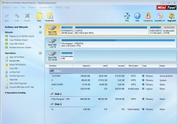

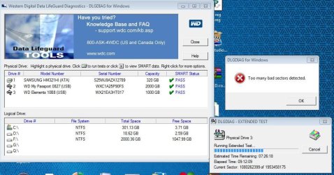

Okay, here's a shot of Disk Management plus a few from Western Digital Data LifeGuard Diagnostics. It is the G: drive.
Why I took the drive apart - Years ago I'd had success with a similar problem by removing the drive, removing some bracketing piece of hardware and connecting the Female data port on the drive to a male SATA attachment on my own enclosure. This particular drive has what seems like permanent hardware preventing access to the power and data connectors. I don't care about voiding any warranty since every piece of failed computer equipment I've owned always seems to wait until one month after the warranty expiration.
Downloading the MiniTool Partition Wizard now - will post back with results. And thanks.

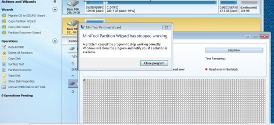

I'm 'guessing' that what you mean by Quick Scan is the Surface Test. I disconnected the other external and attempted to run that test on the problem drive. I attempted it multiple times, always with the same result about 3 seconds after I hit 'start'.

I think you should have completed whatever you wanted to download. If not you may resume the download and complete it. Afterwards plug in your faulty drive only and attempt a Partition Recovery.
In your case it is more or less clear that it is the bad sectors which prevents access to the drive.You may need to do a sector to sector cloning to another good drive and perform data recovery on the cloned drive.
Before that we want to make sure that partition loss is not the cause. With your faulty drive plugged in run MiniTool Partition Wizard. On the left pane under Actions and Wizards, you will see Partition Recovery Wizard listed. Click on Partition Recovery Wizard > Next > select your external drive to be recovered > next > Full Disk > Next > Quick Scan.
Allow Quick scan to complete and post the screenshot of Partitions Found.
If Quick Scan moves slowly and takes more than five minutes, do not persist. Cancel it and quit Partition Wizard.
You should now have a more than 1TB formatted good drive for cloning. I would recommend a 1.5 TB or a 2TB drive so that the drive can be identified easily during the cloning. When you are ready with an empty drive start cloning using System Rescue CD.
Read this and understand. http://www.sevenforums.com/general-...d-tool-cloning-failing-hdd-data-recovery.html
If you have any doubts ask for help.

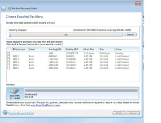

Yes, it was moving slowly so I cancelled after 5 minutes. Screenshot below

From the Quickscan result, I see that the partition is not lost. The partition table is intact in sector 0. However the bad sectors seem to have damaged your File System.
You need to have a drive exclusively for cloning.
(ddrescue will be doing a sector to sector cloning. Sector 0 of your faulty drive which contains the MBR code and the partition table will be copied to sector 0 of the other drive. If you use a drive with data on it, Sector 0 of that drive which contains the MBR code and partition table of that drive will be wiped off and replaced with Sector 0 of the faulty drive. You will then lose all existing data on that drive.)
Software that claim to do data recovery from a RAW drive mostly rebuild the files from scratch if the File System is not found/corrupt. If ddrescue is unable to extract data from the bad sectors even after three passes or unable to deal with the bad sectors because they are irrecoverably bad and gives up, one may have to finally resort to such software :). We shall be doing it with PhotoRec and if it fails with GetDataback Simple for such a contingency.
So we are only making a best effort which may click or buckle. Keep your fingers crossed.
