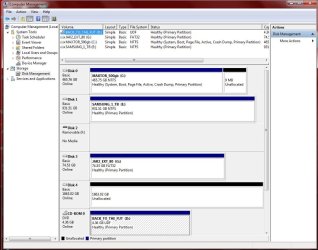

Start :ar: Computer Management :ar: Disk Management :ar:
See if HD shows up here

There is a "Disk 1" in there that says it is unallocated and is 1863.02GB (the HDD is 2tb). Is that it?

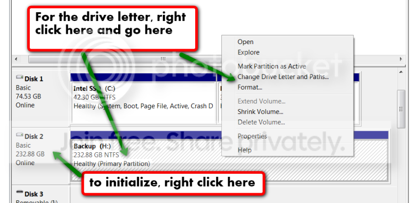

It probably has no drive letter. Maybe it is not even initialized. Go to Disk Management and assign a drive letter.
How do you initialize it? I'll try that when I get home from work and add a letter and see if I can format it then.

Just follow what whs shows above.
Here is another snip from mine of the sub menu
