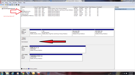

Good Evening,
I have been trying for a few days to get my External Hard Drive working. The HD is out of another laptop. I only mention this because when i removed the HD about a year ago it was fully functionable.
In windows Disk Management, I am able to see the drive in question, however it says that it is not initiated, and unknown. All of the other threads that I have seen about this the HDD reads "Not Allocated" to the right of the drive. However this is not the case with mine.
I have also tried a recovery program, 2 actually, Photorec and MiniTool Partition - Free. Neither of these two programs were able to see the External Drive. Furthermore I have also tried the external drive on another PC which yielded the same results, as well as plugging the drive directly into my laptop, as the primary drive, however the drive failed to load, claiming that there was not an OS found.
I havent tried formatting the drive yet, as I need 1 particular file off of the drive that holds my license keys to all my software.
Any and all help/suggestions would be appreciated :)

Hi Airious,
Welcome onboard.
You are presenting a double whammy :). An external case(?) + the device of interest, the laptop HDD inside. ( How are we to know that the external case is not faulty? Yep, it might have been functional only the other day just like your laptop HDD :). Hope you understand the problem)
To be able to deal exclusively with the laptop HDD, please remove it from the external case, hook it up as a second drive on a desktop and post a screenshot of Windows Disk Management. That would remove another "unknown" device interface inbetween.
Also tell us the manufacturer, model No. and the capacity of the laptop HDD and whether you can hear/feel it spinning inside the case.( Touch only the metal/plastic and not the electronics.)

If you don't care about the data on that diskl, you can just initialize it. Another attempt worth making is to use a live Linux CD and see whether that can deal with it.

I also just downloaded SeaTools and ran the test:
Short Drive Self Test: Passed
Short Generic: Failed
Long Generic: Failed
When viewing the log file, for the Long Generic test i got "Bad LBA" 199 times ( 1 - 199 )
Two interesting factors here; I was expecting the Long Generic test to take some time, but it completed in less than a minute. Also SeaTools is showing the serial number as 1000000000000000CA (I didnt count the 0's, there is just a bunch of them)

This disk must have been knocked or dropped at some time. So many bad sectors is unusual. Seatools can probably not repair it because the default list is full (there are more bad sectors than it can relocate).
If you want to venture into a Linux repair attempt, try this.

Assuming that your external case is not faulty, the prognosis for your laptop HDD is not good. The fact that the long test did not run itself - it wound up in a minute - sounds like the death knell.
( You can check your external case by putting a working HDD in it. If you can read the drive the above statement is valid.)
As whs suggested, you may try a live Linux just not to leave any stone unturned.
Another option is to put the laptop back in its original slot ( laptop) and run Seatools for DOS. Seagate Momentus is a hybrid drive. Just make sure that you can run the regular SeaTools on it from Seagate website support for Momentus drives.
