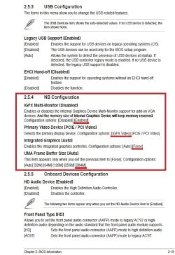

hi can anyone help me i tried changing from my graphics card to onboard as pc was having problems when i change it to onboard the monitor wont come on so tried clearing cmos with jumper then battery still wont click on

Do you have the monitor connected to the onboard video connector from the motherboard, and not still to the graphics card?
You might also double check your EFI settings to see if they are set using what I have underlined in red below to see if that may help. Be sure that you press F10 to save your settings afterwards.
ASUSTeK Computer Inc. -Support- Drivers and Download F1A55-M LX
Hope this helps, :)
Shawn

If you have it set like above, then you might double check the monitor to make sure it's set to receive a signal from the input connection (ex: HDMI, DVI) you have it plugged into the monitor with. Monitors will usually auto detect the signal input, but sometimes you may need to manually select it.
