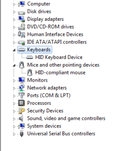

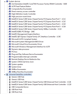

i tried ,, tried and tried but finally i determined the cause of the problem ... its a mouse issue .... i use trust mouse
i pulled out the mouse ... restart pc ... tried f8 advaced boot options ... worked perfect .. no more freezes
i tried other hp mouse ... but unfortunately the problem back again
now i dont know how to fix this issue ( i mean mouse issue ) because i tried difference usb plug ... but nothing helps
all drivers installed , i restore the bios to factory settings ,, maybe i have to upgrade the bios or change the bios settings !!!
thanks
dany

windows 7 ultimate 32bit
Boot into BIOS setup to see if you can find a USB legacy setting, or any other USB setting to try. That may be all it takes. If not then you don't really need the mouse to navigate there or in F8 menu which is why it is set up to use the up and down keys.
